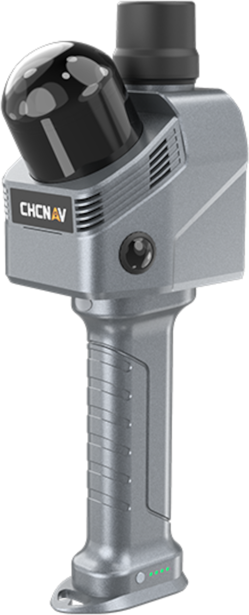

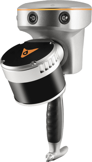

The CHCNAV RS7 is a handheld real-time 3D LiDAR SLAM scanner for collecting building interiors, enclosed facilities, and exterior building features or outdoor scenes within a 20-to-30-meter range.
Full-constellation GNSS (GPS, GLONASS, BeiDou, Galileo) with 500-Hz, 0.5°/hour IMU for georeferencing scans collected or started/ended outside.

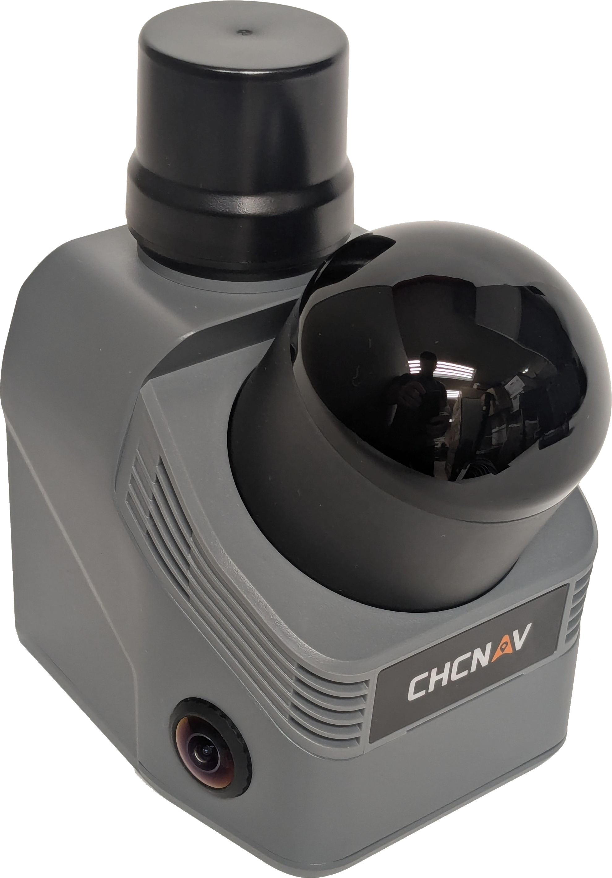

64-channel LiDAR at 1.15 million points/second with better than 1 cm relative and 3 cm RMS horizontal and vertical accuracy.
360° × 189° field of view captures floors and ceilings simultaneously - one collection completes the scan.
Dual 12 MP cameras (down-sampled from 24 MP with Sony binning, combined 48 MP); colorized point clouds, 3D mesh, and 3D Gaussian Splat outputs.

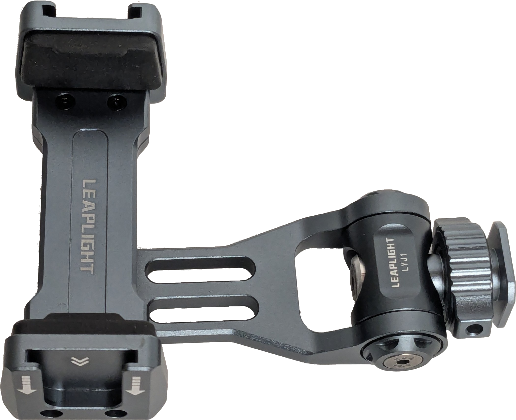

Easily mount phone-size Android devices to the RS7 with the included bracket.

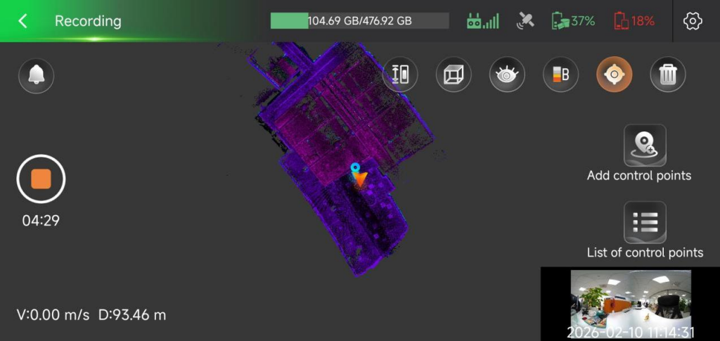

SmartGo field software (included) controls collection and allows point cloud preview to confirm coverage before leaving the site.

512 GB internal storage, IP64 rated. Lightweight 2.6-lbs. with a 150-minute battery integrated in the handle - no external cables or batteries.

The LiDAR scanning range is up to 40-meters with a 20-30 meter ideal scan range.
The LiDAR's sensitivity allows the RS7 to perform well in dark interiors where surfaces absorb light.

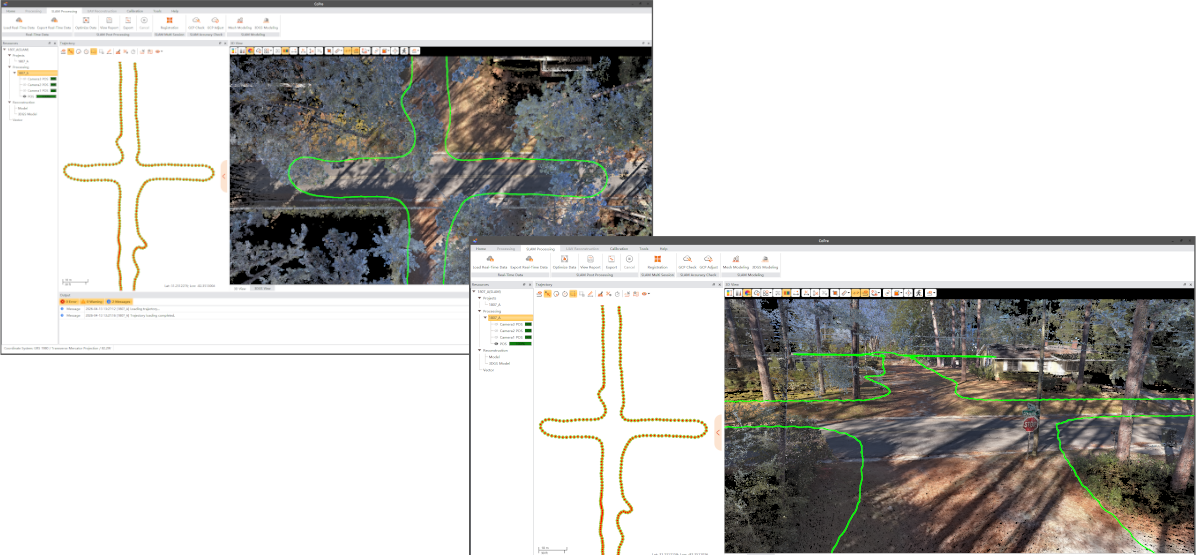

GNSS-Grounded Positioning and Projected Coordinates
CoPre handles GNSS trajectory processing, coordinate transformation, and projection as native steps in the standard post-processing workflow.
By connecting to a local base or CORS before starting a scan, CoPre produces a georeferenced point cloud in a state plane zone or custom project coordinate reference system.
For firms already using CHC, SG and iG GNSS receivers, the coordinate system setup in CoPre will be familiar. NATRF2022 is already supported, of course.

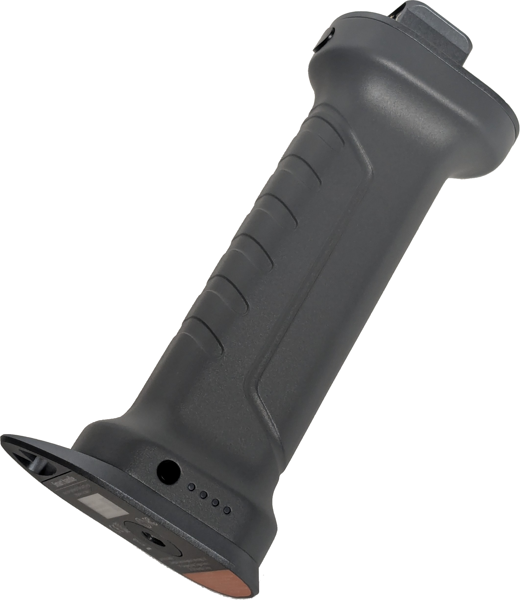

The 150-minute RS7 battery is integrated directly into the handle, there is no external battery pack, no charging cable over the operator's shoulder, and no connector to snag on a door frame or cabinet edge.
The RS7 weighs 2.6 lbs with the battery handle - less than many field tablets.

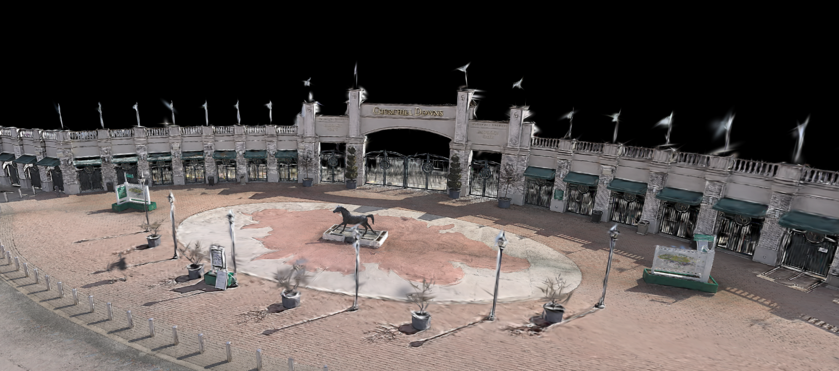

CHCNAV's HPGS 2.0 engine uses this imagery to generate 3D Gaussian Splat (3DGS) outputs (requires Flagship kit or annual subscription see Pricing) alongside traditional colorized point clouds and mesh models. 3DGS produces photorealistic, navigable scene reconstructions that convey material finish, color variation, and spatial context in a way a colored point cloud cannot.
For heritage documentation, insurance claims, forensic evidence packages, or client presentations where the audience is non-technical, the 3DGS output is a meaningfully different deliverable from a standard point cloud.

SmartGo runs on any Android and connects to the RS7's onboard system during field operations. Scan control, real-time point cloud preview, and data management. You can confirm coverage before leaving the site rather than discovering gaps back at the office.

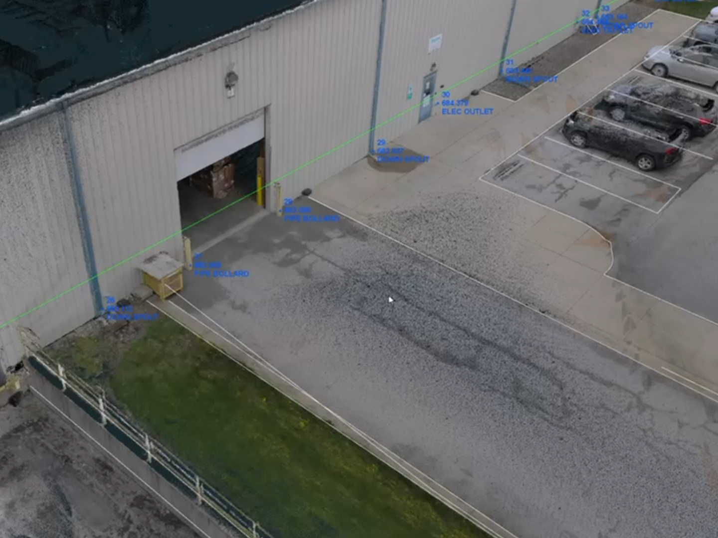

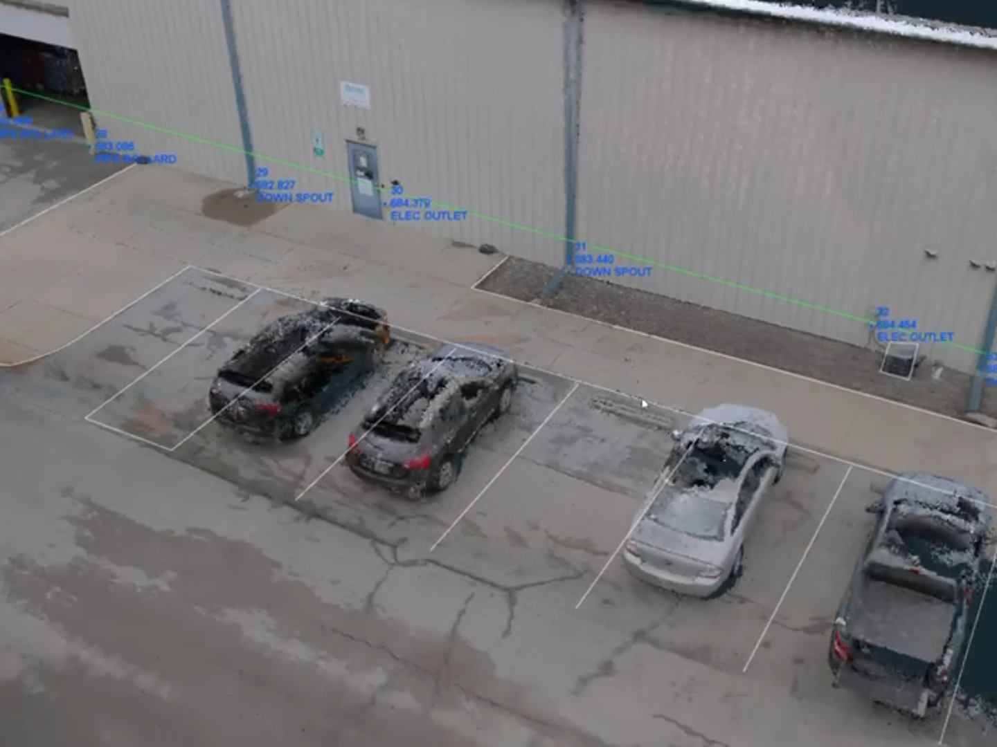

CoProcess allows data extraction from raw point clouds. Filter point clouds to ground, draw linework, export .dxf files. Set up layers and create deliverables from scan data in CoProcess.

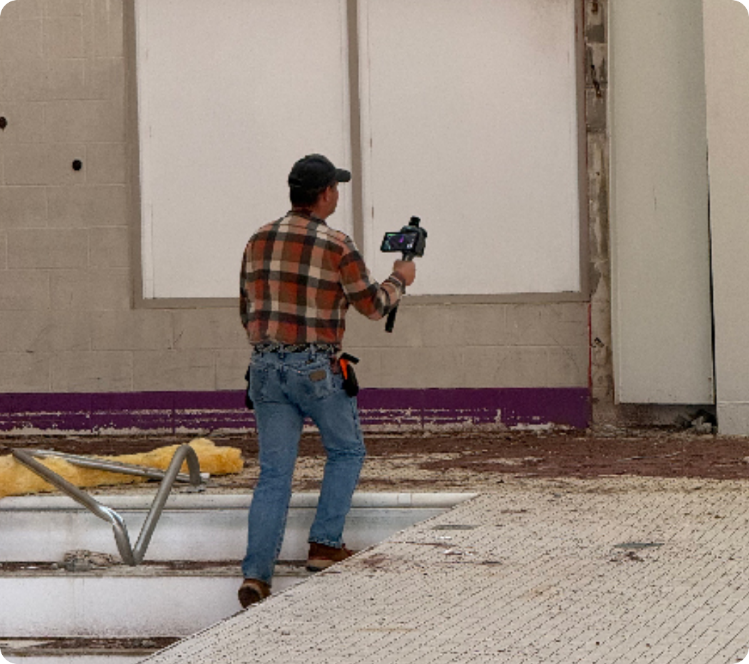

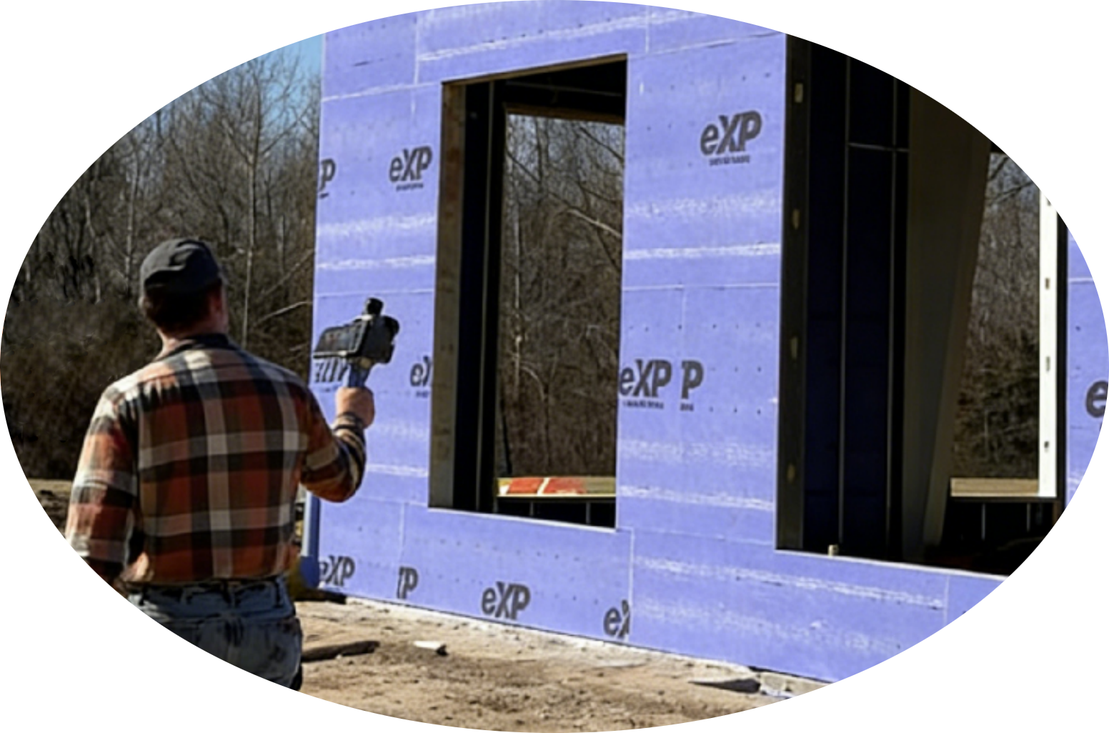

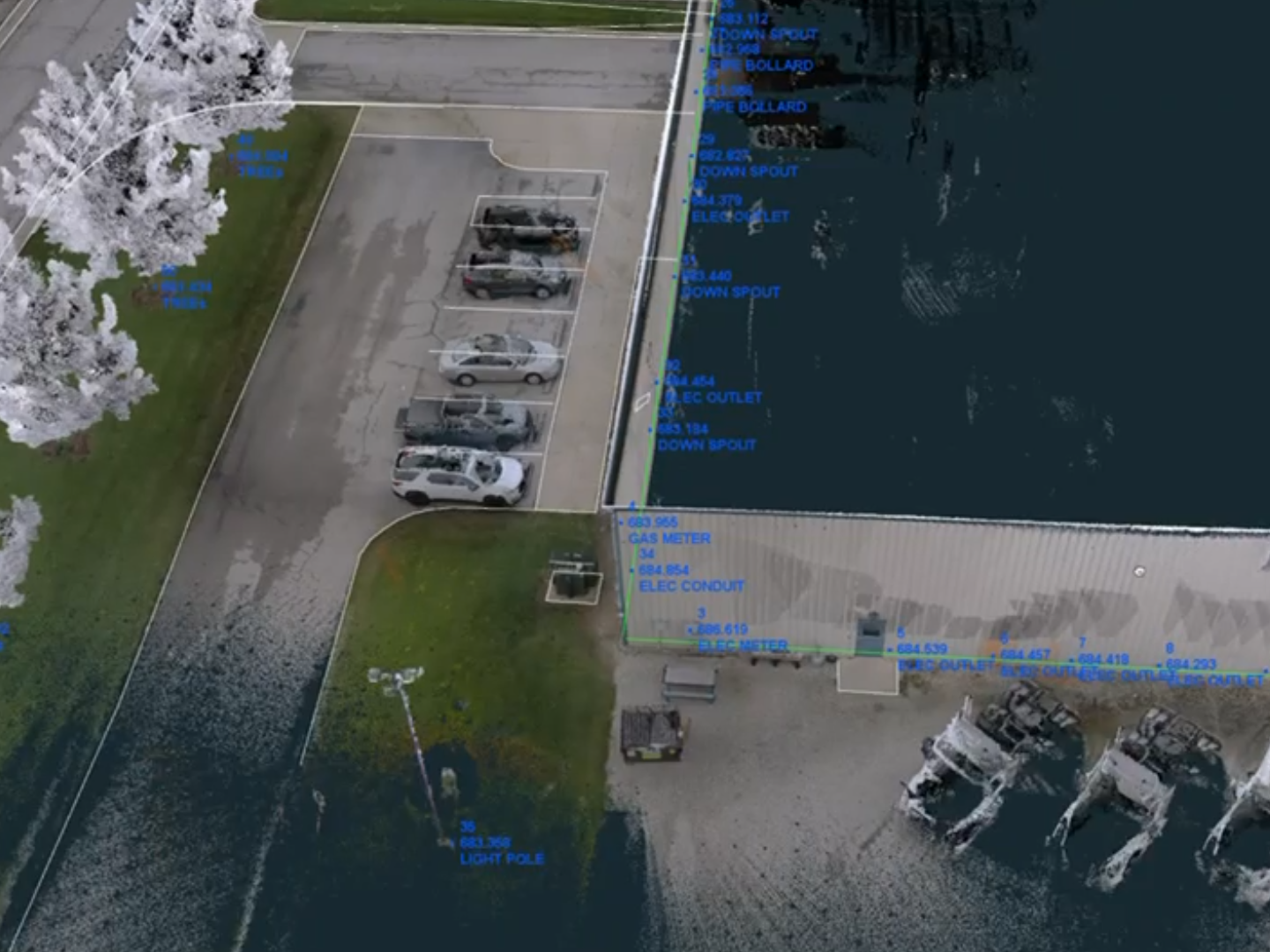

  • Architectural surveying and as-built documentation - floor plans, section cuts, and BIM-ready geometry extracted from a single walk-through scan; no targets, no setup time, no tripod
  • Interior design and renovation - precise existing conditions capture before design, with colorized point clouds and mesh models for coordination across trades
  • Public safety and forensic investigation - rapid scene documentation in low-light conditions that captures every surface, dimension, and spatial relationship in a repeatable, legally defensible format
  • Cultural tourism and heritage preservation - high-resolution colorized point clouds and 3DGS outputs for documentation archives, virtual tours, and conservation records

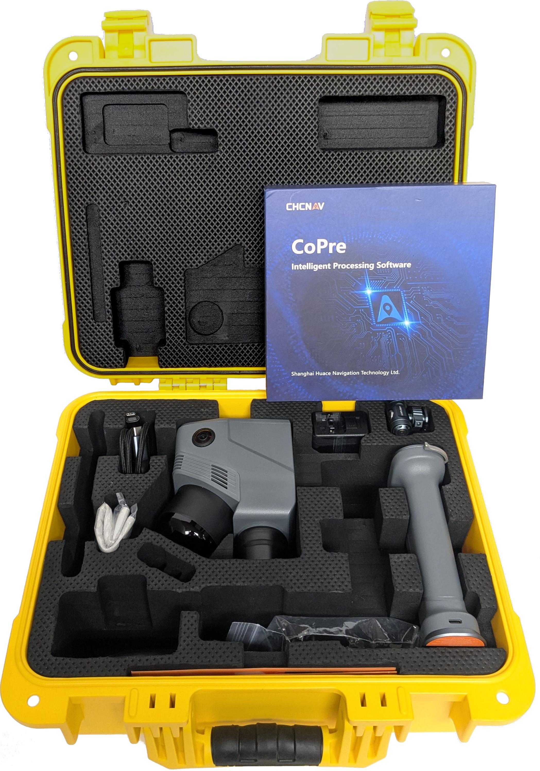

What's in the case?
The RS7 kit is a complete system, just BYO-Android.
Carry Case Contains
RS7 body
Battery Handle
Quick Start Guide
Phone Collector Mount (affixes to RS7)
Data and Charging Cable

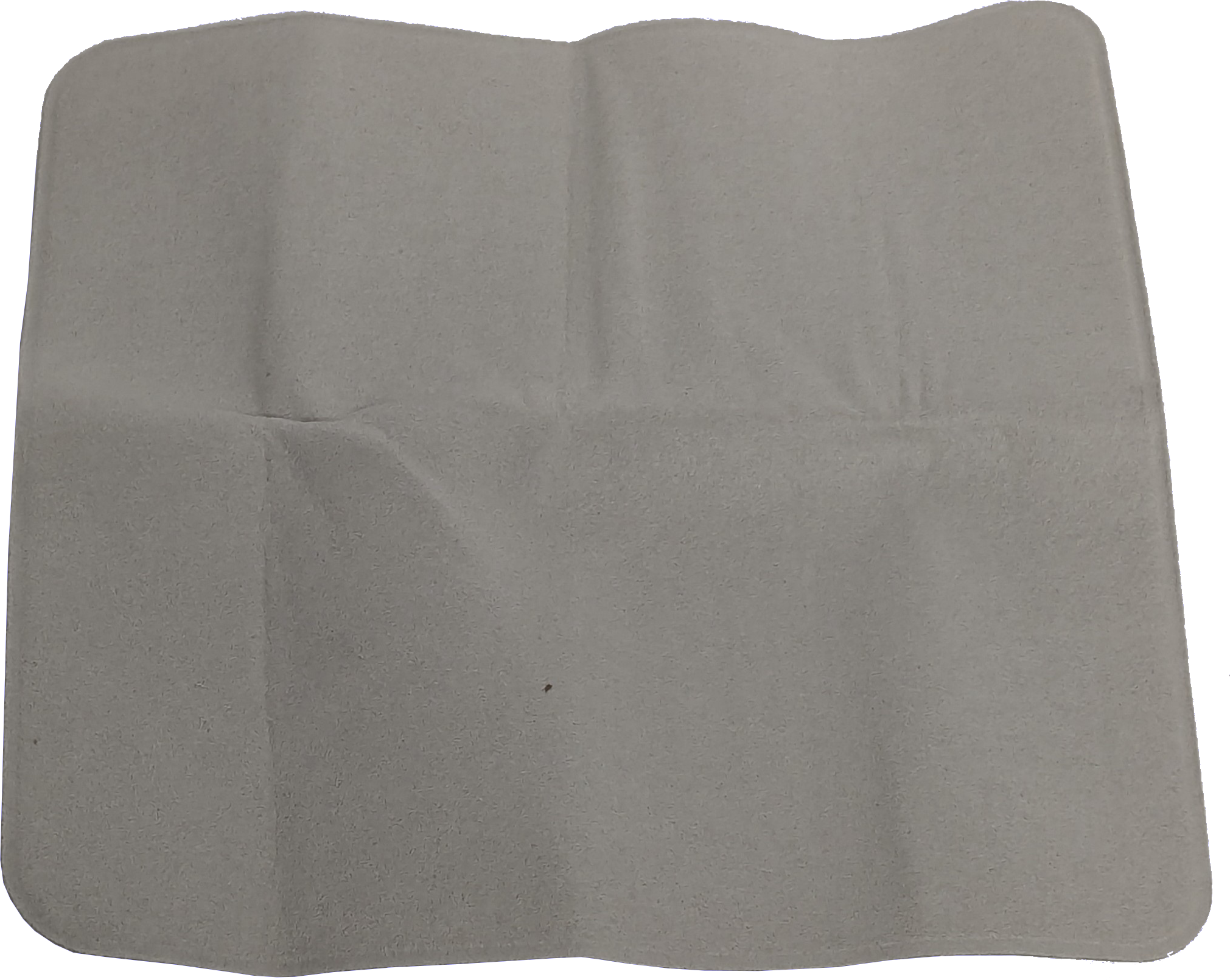

Microfiber Cloth

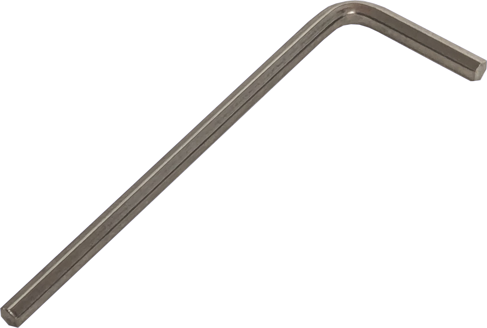

Hex Wrench
