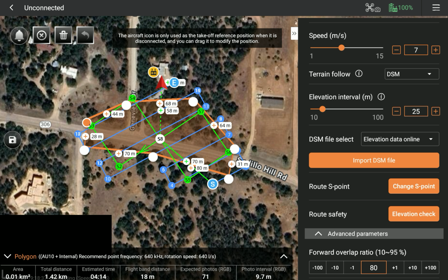

Scanning
Model Flight Time @100m (mins) Flight Time @50m (mins) Collect Time @100m (mins) Collect Time @50m (mins) Area Covered @100m (ac) Area Covered @50m (ac)
AA450 3.5 4.25 10.8 9.8 8.81 6.26
AU10 3.5 4.25 6.8 10.1 8.53 6.26
  • Flight time for each payload is from SmartGo mission planner estimate
  • Collect Time represents real flight time + time each sensor required on ground before and after takeoff
  • Area covered is an estimate of acres from Pix4D Mapper processing of imagery

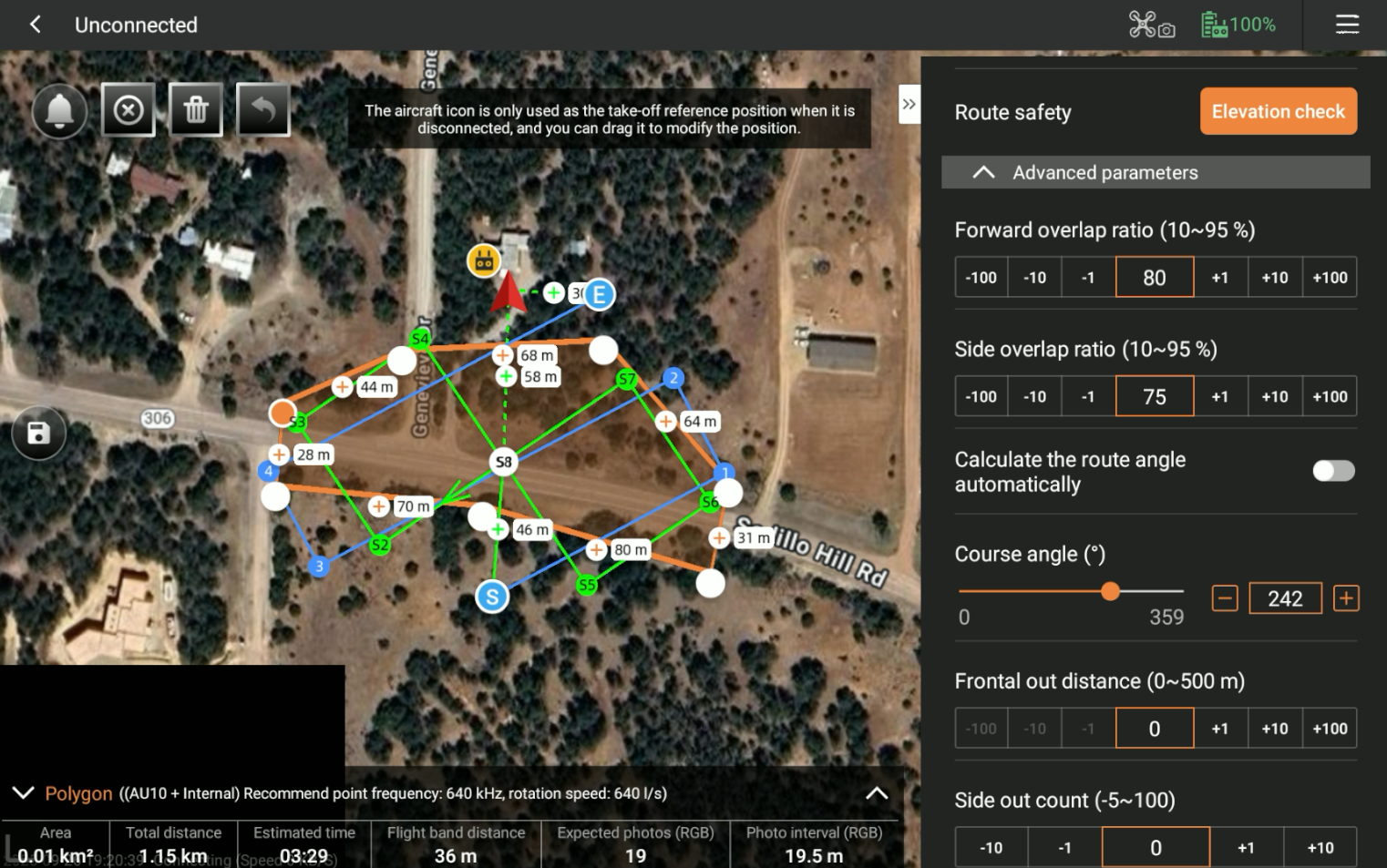

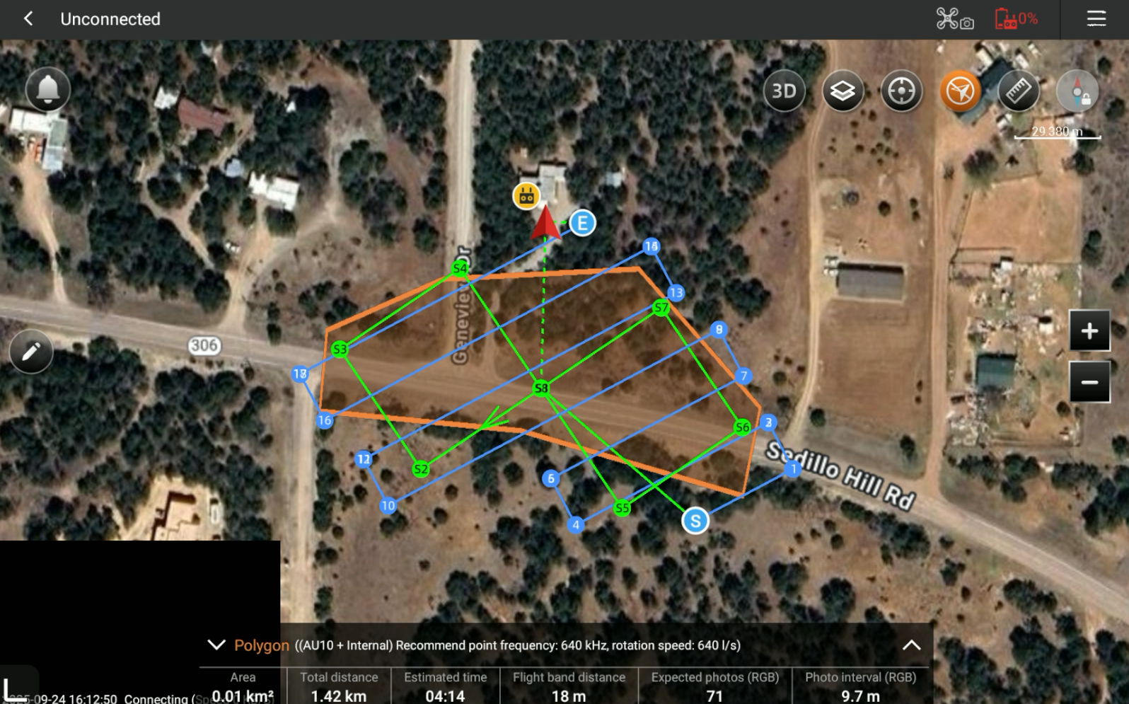

Each scanning mission was planned with 80% front overlap, 75% side overlap, and 7 m/s flight speed. These selections can be changed and were the defaults after selecting each payload and altitude.
100m AGL Mission
50m AGL Mission

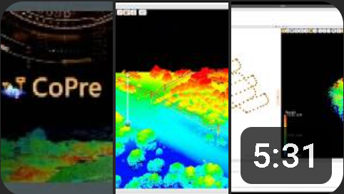

CoPre Point Cloud Processing
[ See CoPre Point Cloud Processing Video ]
CoPre2 Post Processing
  1. Import raw project data, use Auto Solve wizard
  2. Select state plane coordinate system and geoid
  3. Import base RINEX for PPK trajectory processing
  4. Set noise filtering, and minimum distance from sensor filtering
  5. Process images, turn off colorization (if colorization desired, use 'remove unshaded points' feature')
  6. After Auto Solve, a .LAS is saved to project directory, JPG images are saved with a 'metashape.txt' file containing position and orientation data
  7. Optionally, import GCP file and process orthomosaic in CoPre
'Remove unshaded points' when colorizing provides a high quality colorized point cloud. In some cases it can also cut the point cloud density by half or more. Processing without colorization provides maximum point cloud density.

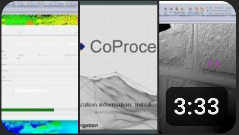

CoProcess 2 DEM Processing
[ See CoProcess 2 DEM Video ]
CoProcess2 Ground Filtering and DEM
  1. Import georeferenced point cloud
  2. Select 'Terrains > Wizard' and 'Advanced Settings'
  3. Break the job down into blocks, or process as single block
  4. Choose whether to classify buildings and vegetation, or to just classify ground
  5. Set ground filtering parameters for terrain
  6. Set DEM resolution
  7. Wizard will process and classify, when finished saving .tif DEM ground surface in same directory as .LAS
  8. 'Check DEM' function used to bring in ground points and compare to the DEM surface

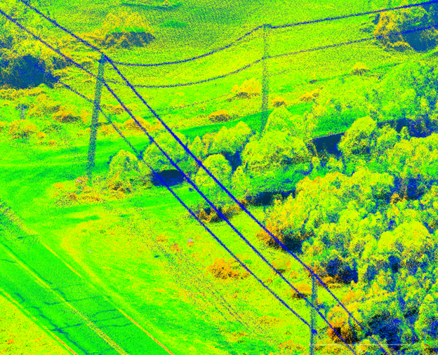

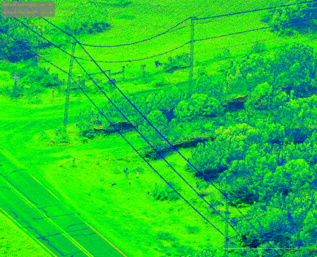

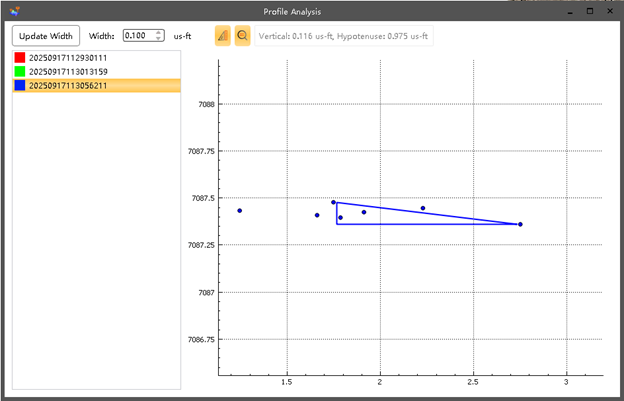

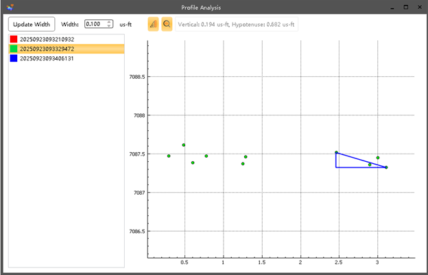

Point Cloud Density and Noise
Point cloud density in 1 sq/m area was measured using CoPre, selecting the same position in each cloud at a visible asphalt imperfection.

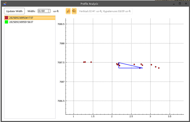

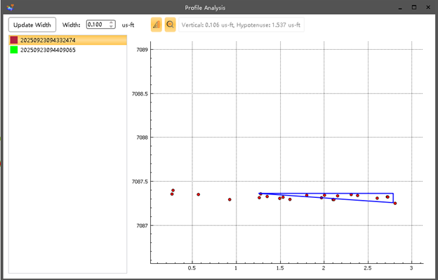

Point cloud vertical noise was measured using a .1 sft wide strip along asphalt centerline.
Model Density @100m AGL (pts/m2) Density @50m AGL (pts/m2)
AA450 218 302
AU10 115 236

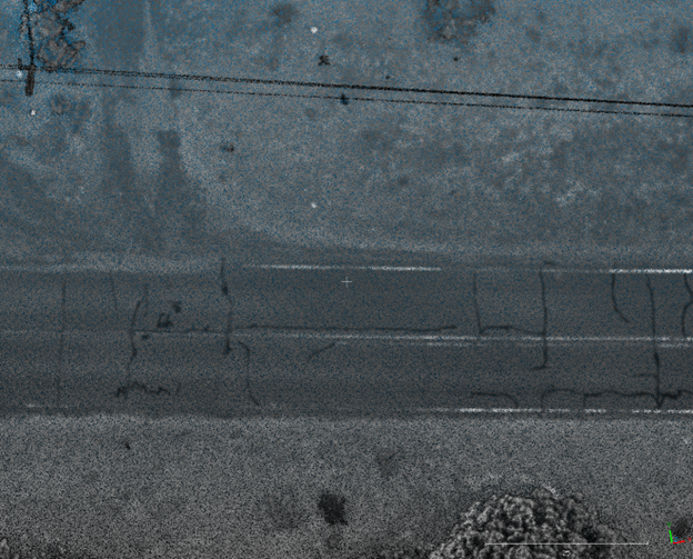

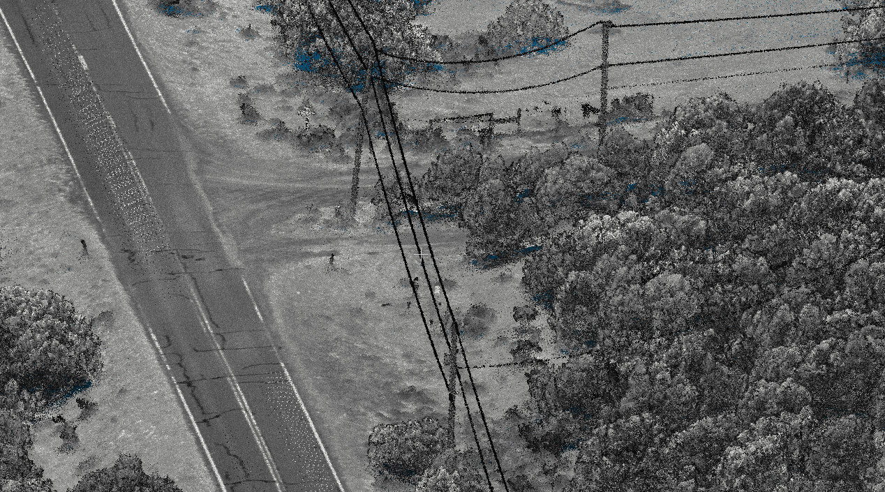

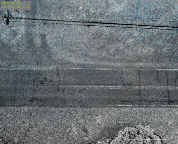

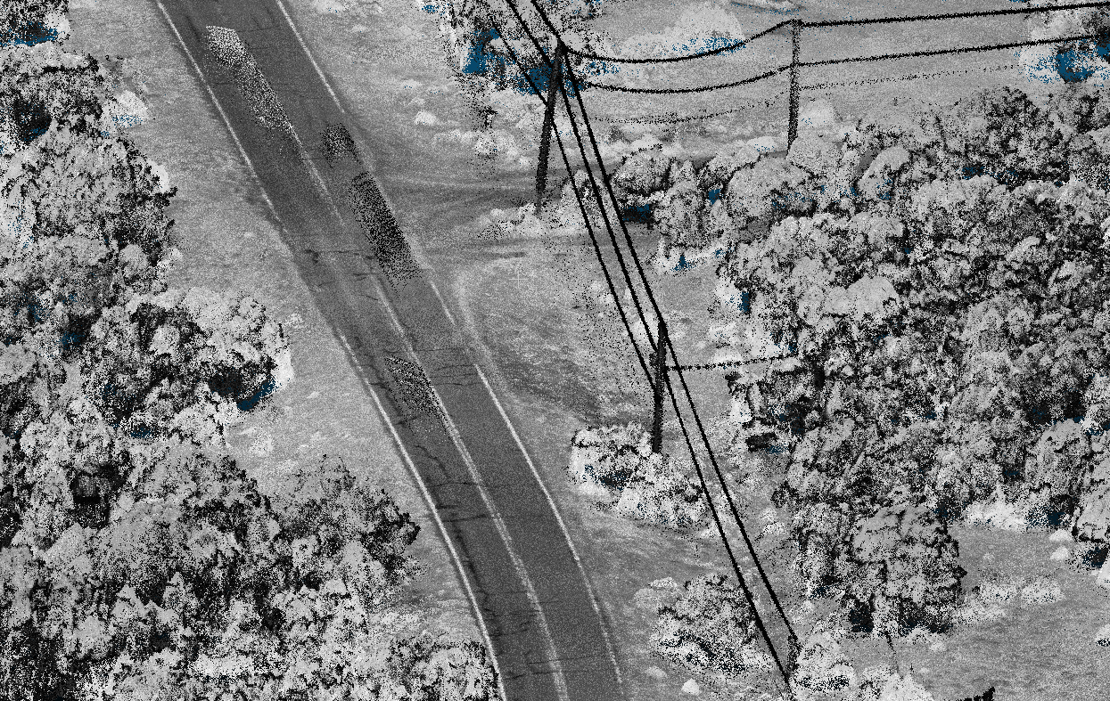

AA450 @50m AGL Intensity
AU10 @50m AGL Intensity
AA450 @50m AGL Intensity Blue, Green, Yellow, Red
AU10 @50m AGL Intensity Blue, Green, Yellow, Red
AA450 @50m AGL Intensity Top View
AU10 @50m AGL Intensity Top View
AA450 @100m AGL Vertical Noise
AU10 @100m AGL Vertical Noise
AA450 @50m AGL Vertical Noise
AU10 @50m AGL Vertical Noise
